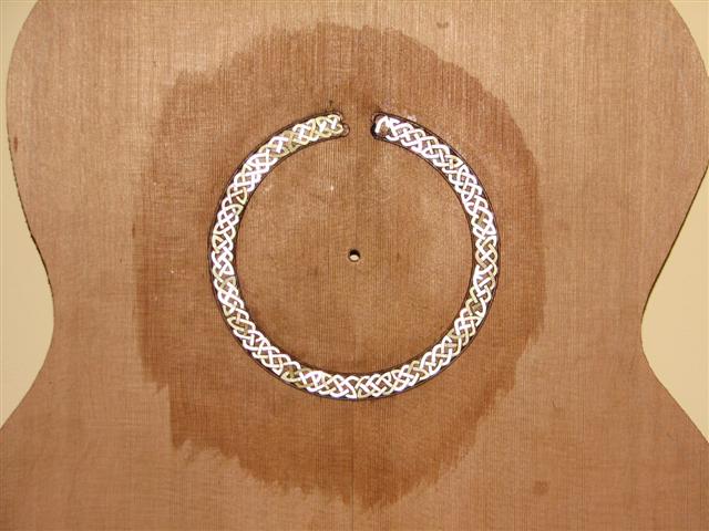

Rod, I just installed a multi-piece inlay that I got from Andy. I was concerned about it coming apart when removed from the cardboard backer too. I called Andy and he told me to take a piece of clear packing tape and press it down over the entire inlay to hold things in place. He said the glue was water soluble and the tape would hold things together after the backing was removed.
I was really glad I called him because when the backing came off all the little pieces were loose from each other. They were stuck firmly to the tape though. I think this inlay had 37 pieces.

here is the latest picture. I've got all the pieces "welded" in and I'm going to level all the pieces, than recut the outer chanel to clean it up to get a nice sharp edge, than flood it all with black epoxy. Leave it for 48 hours or more (till it's really hard) than level again. Cross your fingers
Bad lighting but you get the picture.
